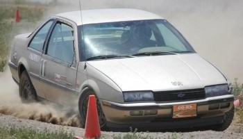

So, we all can reasonably agree on which struts are best for daily/street use, but I am wondering if anyone has opinions on struts for "off road" use. I bought a car just to Rally and it needs new struts, BAD. I want to invest in something that is going to perform and last through a few seasons of being completely beaten on.

You above photo is also showing a lot of body roll... What do you have for sways on that car? That should help some by getting possibly a Z51 on there and maybe a larger front bar, but being auto-x you don't want to over do it. FE7 would be the best option for the front I believe.

To clarify, the rear shocks for a SAAB are direct bolt ins? I read over that thread once, but not in too much detail. I don't think I need the adjust ability that a custom built strut would provide, hell I'm not sure I even need it in the rear! Not looking to go crazy with the car just yet. As you can see from the above pic, I just need struts that actually do something!
As for the body roll? I have it all on there:

I have a shock tower brace en route to my house as I type as well. I think you are not seeing body roll, but the absolute lack of a strut that performs to any capability and half dead shocks. Bear in mind that was a downhill hard left turn.
And ahem, it's Rally Cross. :sparta:

And yes thats body roll.. The car is trying to go left and the body is rolling to the right... Granted yes this can be fixed with new shocks/struts if they are completely blown, but KYB is about the best bolt in over the counter option for you. That's why I recommended the Koni stuff and I wasn't sure where the rest of your suspension stood so that's the reason for the swaybar comments.
