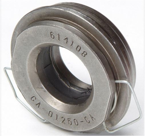

2) The photo's of the 2 bearings, I'm not sure which one is right, Both keep popping up. (The existing bearing in the 88 is getting cut into/grooves in the back of it from the clutch fork). However, I do not know what kind of bearing is already in the vehicle.

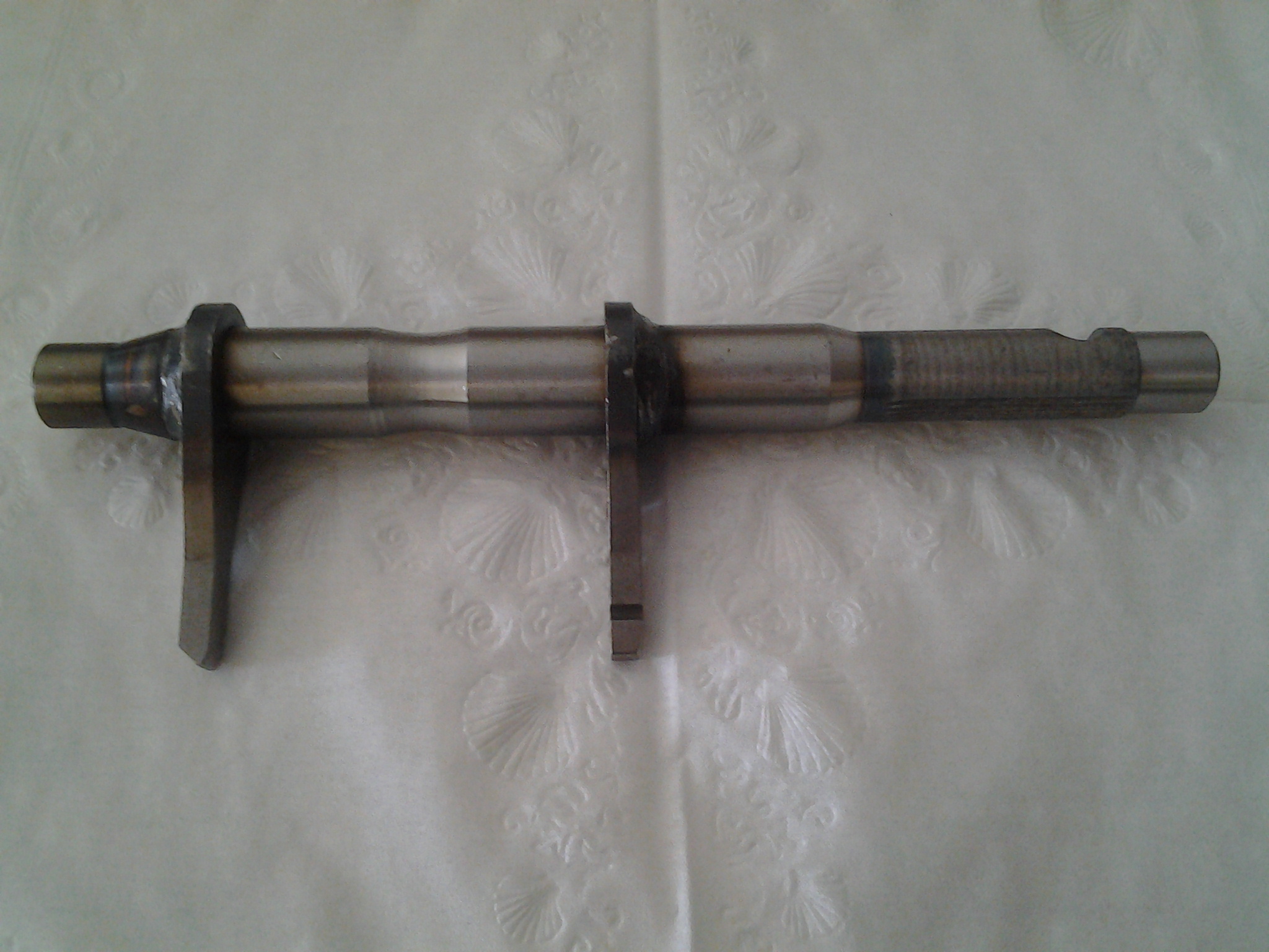

3) The photo of a Clutch fork, I bough this. I'm hoping its the right one for the 88 Beretta v6 manual trans?

Bearing 1: Bearing 2:

This is the Clutch fork I bought. I'm hoping it is the correct one.
Side A: Side B:
Side A: Side B:

There is no fork installed in the transmission picture. Looks like that may be the 92+ version with the hydraulic throwout bearing. Bearing 1 matches up to the fork you posted, which is the 90-91 style. Bearing 2 I do not recognize...it may be the 87-89 style. I do know that the fork you pictured is incorrect for an 88. I have an 87-89 parts trans I can snap a pic and show you that design.

I know for sure the 1988 Beretta That has the problem, it has a fluid piston for the peddle, and another one for the clutch fork to move.woody90gtz wrote:There is no fork installed in the transmission picture. Looks like that may be the 92+ version with the hydraulic throwout bearing. Bearing 1 matches up to the fork you posted, which is the 90-91 style. Bearing 2 I do not recognize...it may be the 87-89 style. I do know that the fork you pictured is incorrect for an 88. I have an 87-89 parts trans I can snap a pic and show you that design.

I did not include it earlier because I can not tell if it is for a v6 or not. But It has the same clutch fork I bought. If you can post some photos of whatever you have of the 87-89 style trans, that would be much appreciated. This way I will know for sure what it looks like, and have a better idea of what to expect.

Here are the pics. Looks like the same throwout bearing as 90-91.

That clutch fork is defiantly different from the one I bought like you said.
