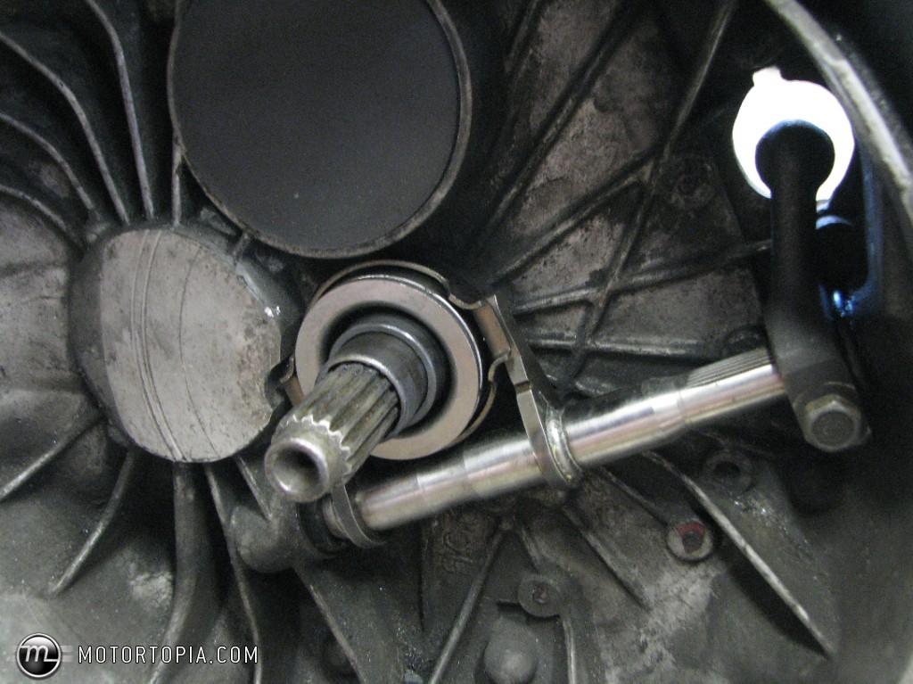

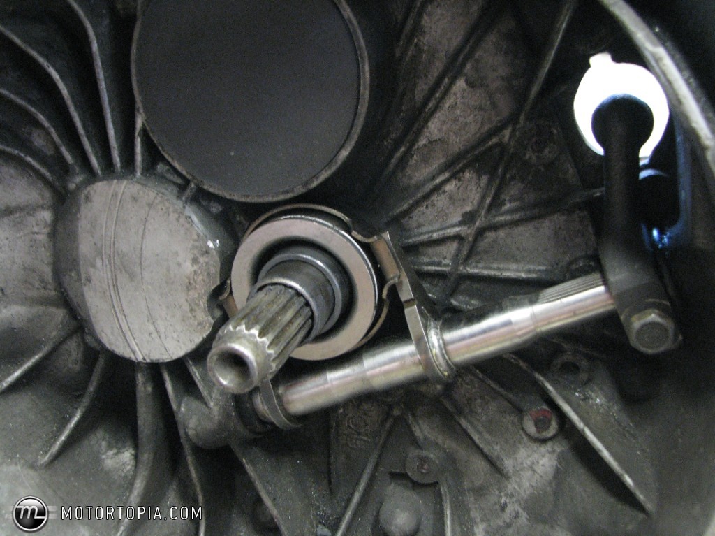

1) The photo of the v6 Manual trans, I'm wondering if this is how it looks on the 1988 Beretta.
2) The photo's of the 2 bearings, I'm not sure which one is right, Both keep popping up. (The existing bearing in the 88 is getting cut into/grooves in the back of it from the clutch fork). However, I do not know what kind of bearing is already in the vehicle.

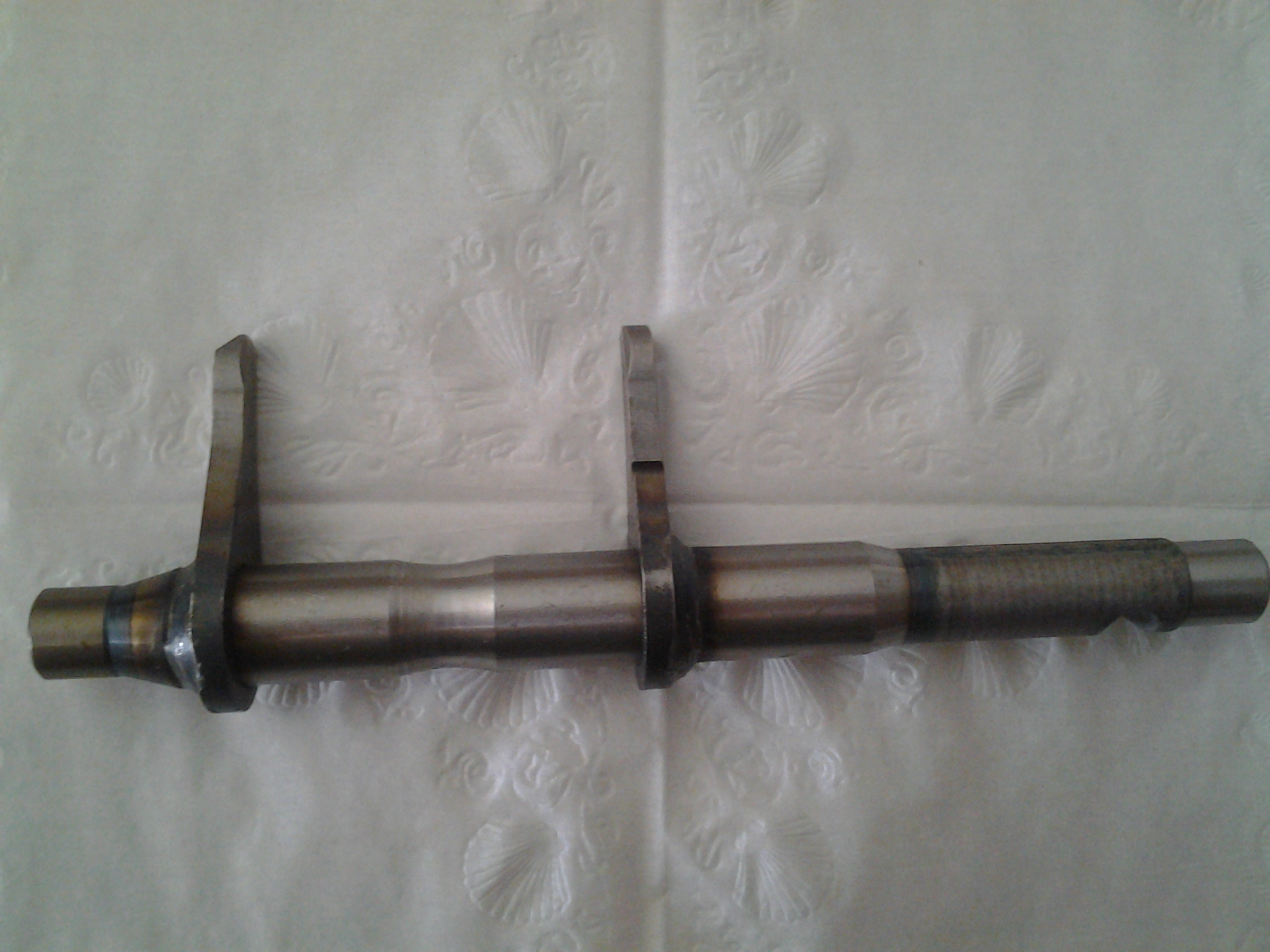

3) The photo of a Clutch fork, I bough this. I'm hoping its the right one for the 88 Beretta v6 manual trans?
This is Manual 6 SPD transmission For the Beretta 2.8, 3.1, 3100 v6 engines. What year or series, I do not know.
V6 Manual Transmission

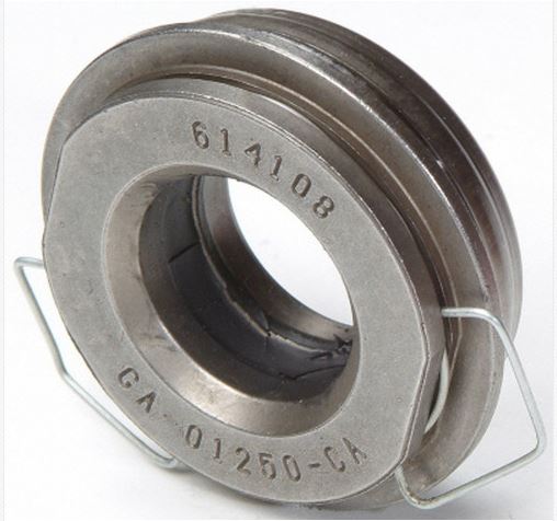

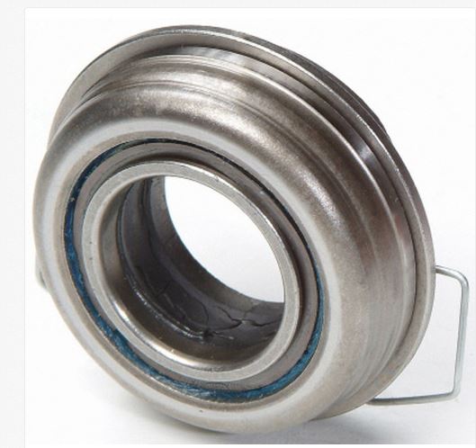

I found 2 types of bearings. I do not know which one is correct yet.
Bearing 1:
Bearing 1 Front
Bearing 1 Front
Bearing Front.JPG (19.22 KiB) Viewed 5718 times

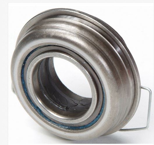

Bearing 1 Rear
Bearing 1 Rear
Bearing Rear.JPG (16.71 KiB) Viewed 5718 times

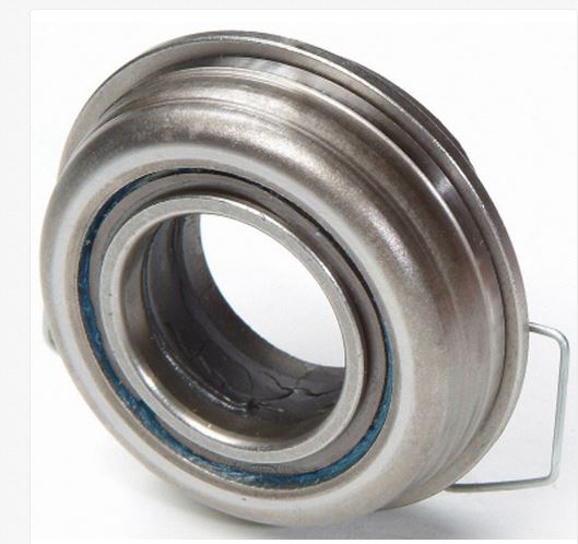

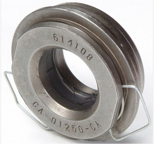

Bearing 2:
Bearing 2 Front
Bearing 2 Front
Bearing 2 Rear
Bearing 2 Rear

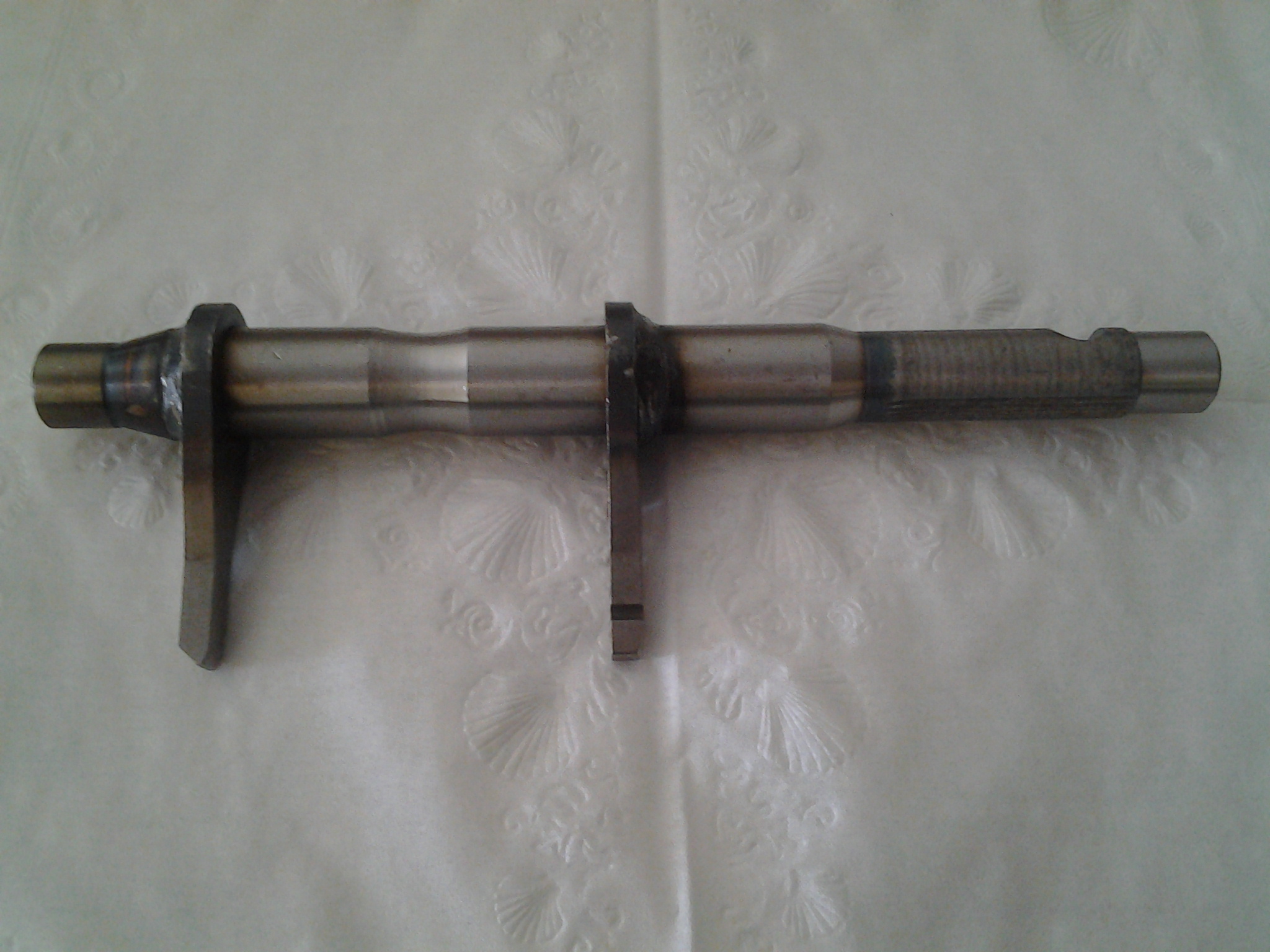

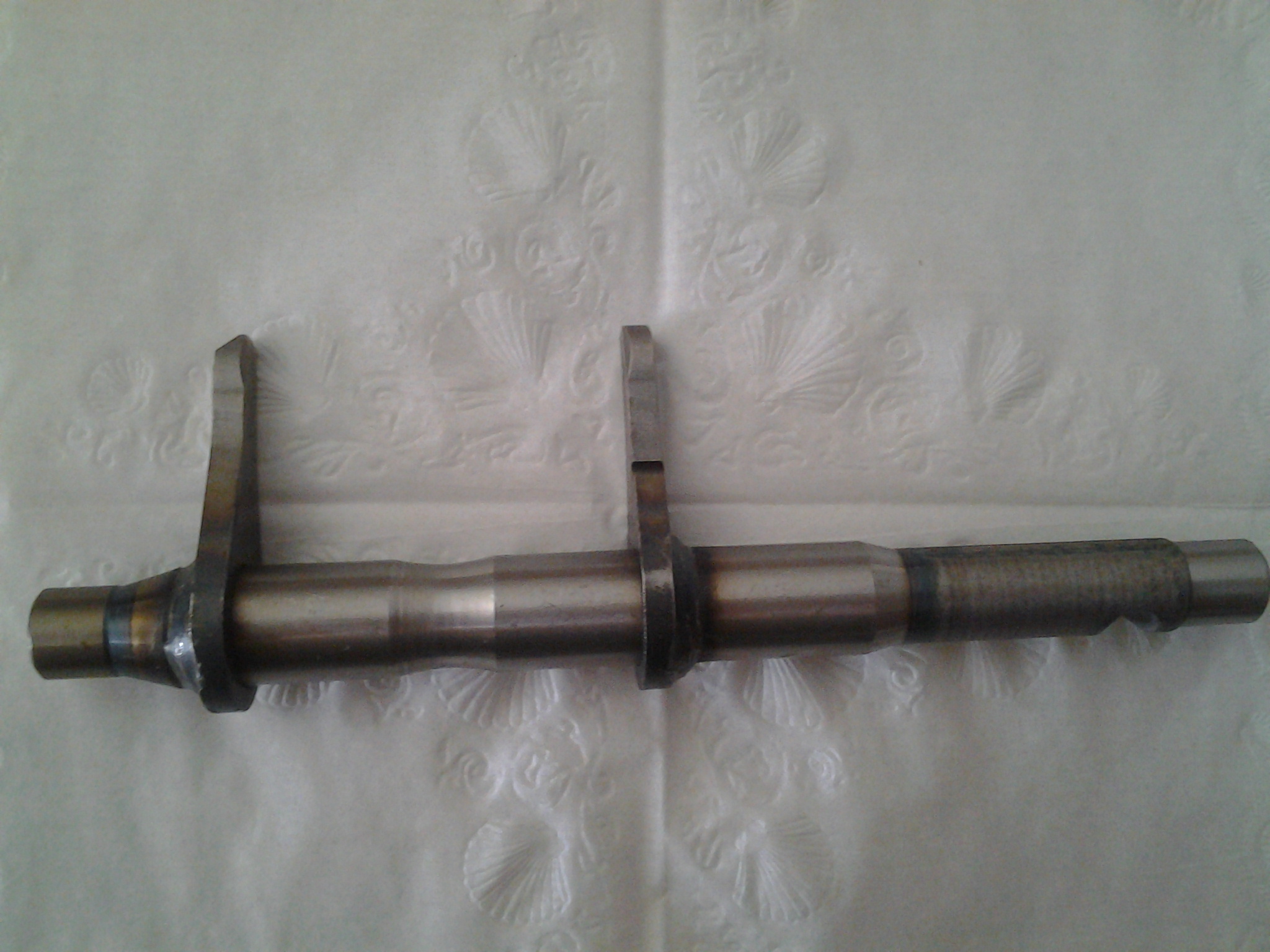

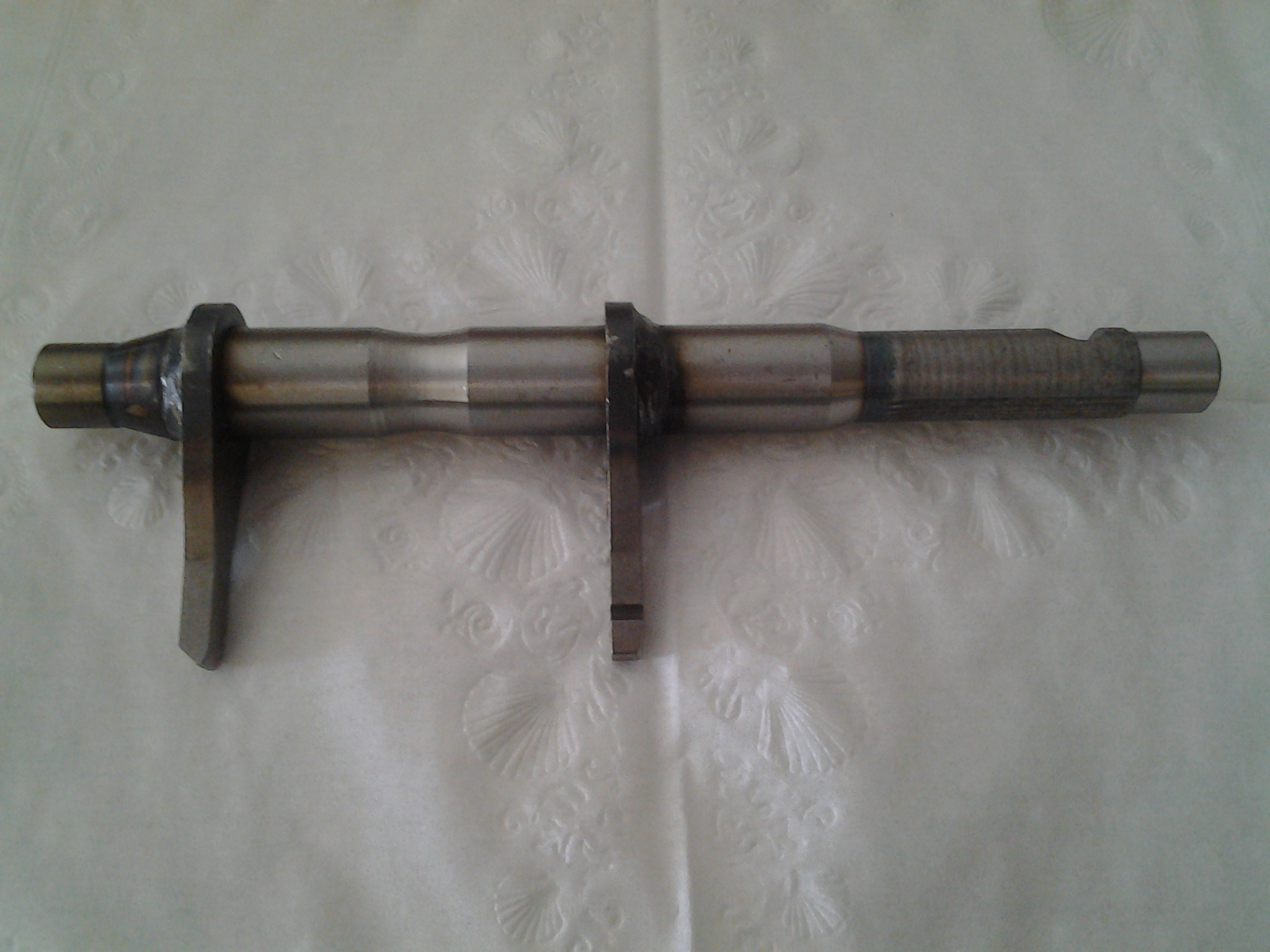

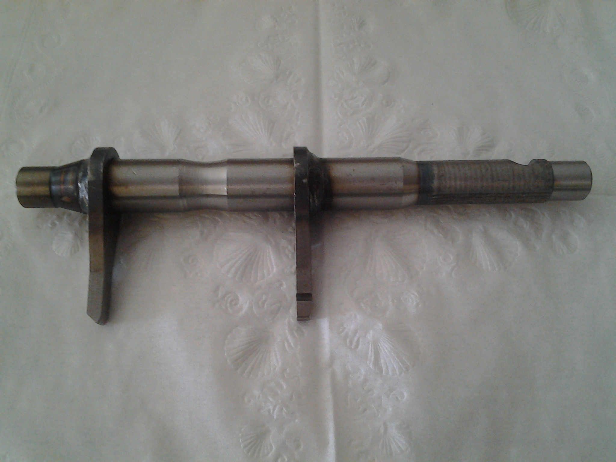

This is the Clutch fork I bought. I'm hoping it is the correct one.
Side A:
Clutch Fork Side A
Clutch Fork Side A
Side B:
Clutch Fork Side B
Clutch Fork Side B
Posts: 4778
Re: Clutch fork. Just to verify.
There is no fork installed in the transmission picture. Looks like that may be the 92+ version with the hydraulic throwout bearing. Bearing 1 matches up to the fork you posted, which is the 90-91 style. Bearing 2 I do not recognize...it may be the 87-89 style. I do know that the fork you pictured is incorrect for an 88. I have an 87-89 parts trans I can snap a pic and show you that design.

woody90gtz wrote:There is no fork installed in the transmission picture. Looks like that may be the 92+ version with the hydraulic throwout bearing. Bearing 1 matches up to the fork you posted, which is the 90-91 style. Bearing 2 I do not recognize...it may be the 87-89 style. I do know that the fork you pictured is incorrect for an 88. I have an 87-89 parts trans I can snap a pic and show you that design.
I know for sure the 1988 Beretta That has the problem, it has a fluid piston for the peddle, and another one for the clutch fork to move.

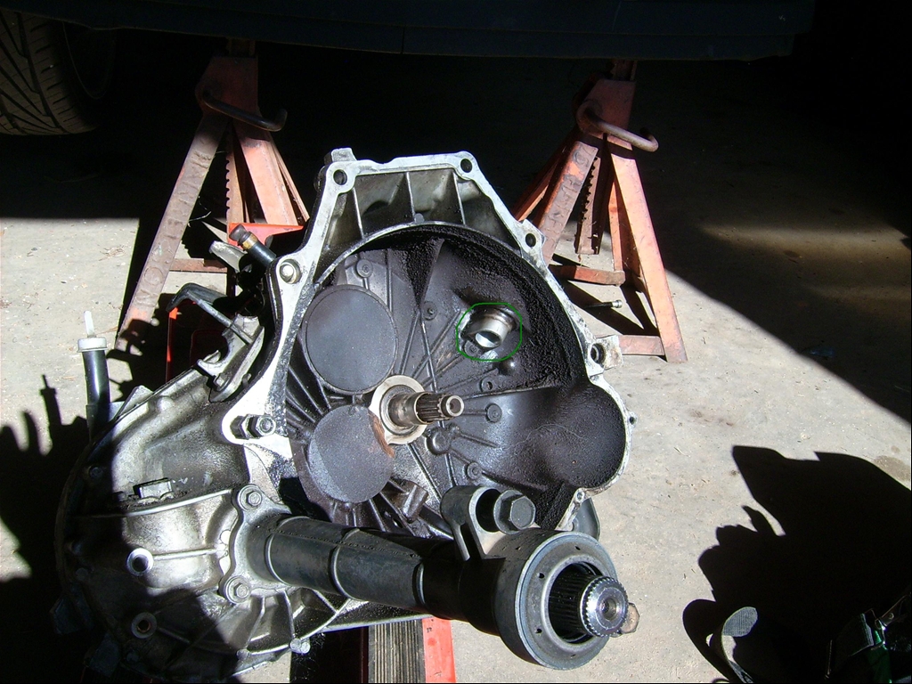

In that photo (Its not my photo, I found the photo online off a Beretta, was not labeled what kind of trans or year). The green circle is one side where the fork inserts, the other side is visible.

That pic is actually my trans (yes, v6). It is the 90-91 setup where the slave bolts directly to the bellhousing. I'll get a pic of the older style tonight.

That clutch fork is defiantly different from the one I bought like you said.
